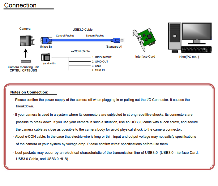

    After installing the driver of the BU1203MC, the camera will appear in the Device Manager of windows under a custom device "TOSHIBA TELIR Digital cameras, and not in the Cameras list check the attached image.Is there a way to change this setting? Otherwise I'm not able to use it with the Camera App of Windows.

    After installing the driver of the BU1203MC, the camera will appear in the Device Manager of windows under a custom device "TOSHIBA TELI(R) Digital cameras, and not in the Cameras list (check the attached image).

    I checked the camera manual, its driver uses the COM to USB system and its driver is recognized as a COM or USB device, but it is not recognized as a camera device since it is not a common camera, you can try using a third-party application to simulate the video connection and try to retransmit as manycam but I'm not sure it will work.
    But natively, it is not possible to use it in the Windows camera application.
