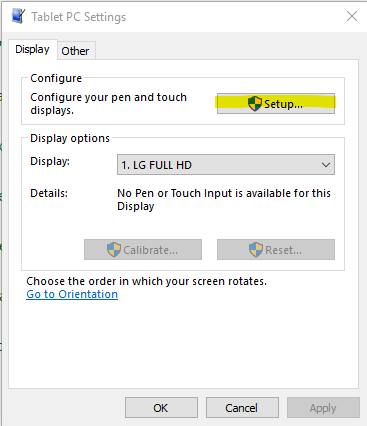

    I've added a touchscreen monitor to my computer as an additional monitor but Windows 10 inputs the touch commands to the primary monitor, which my Touch screen monitor is not.
    I've read online that the process to identify which monitor the touch input should be deployed on is Control Panel->Tablet PC Settings ->Configure->Setup however this does nothing. Clicking setup brings up the processing circle, but a window does not load.
    Touch Setup for second monitor not working. dfb483cf-3595-4668-924e-21d56d2d345b?upload=true.png
    I have found this article with another user exhibiting this issue, and a solution is not included.
    https://answers.microsoft.com/en-us...ccesible/84197f07-a022-4551-b1f7-1e9f618ba487
    I've checked the drivers, processed all updates and restarted HID devices in device manager.
    As a work around, I've made the touch screen the primary, and the touch functionality is working like a charm, but I don no want this to be the primary monitor
    Is there a way to force this setup process to start, or a service that needs restarting which may be stopping from running?
    HalDimond, Jun 28, 2019
