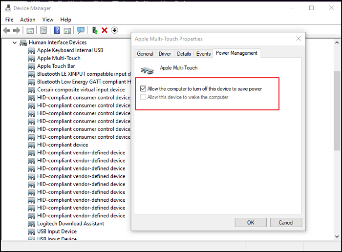

    If you do not like this behavior, the control of Windows 10 can be taken away by changing the power settings.
    • Right-click on the Windows Start button and then click on Device Manager
    • Expand the Human Interface Devices
    • Locate anything which says TouchPad or Multi-Touch
    • Right-click on it, and select properties
    • Switch to Power Management
    • Uncheck the option which says— Allow the computer to turn off this device to save power
    • Click on the Ok button to save the changes.
    Having done this, Windows 10 will not be able to disable the device based on the power plan. Be aware that turning off the setting may result in a higher battery drain.
    That said, Windows 10 Power Plans do not offer any specific settings to disable the option that can turn off the device based on battery power. That’s where the device-specific Power Management settings come into the picture. Once the option is unchecked, Windows doesn’t have any control over those devices.
