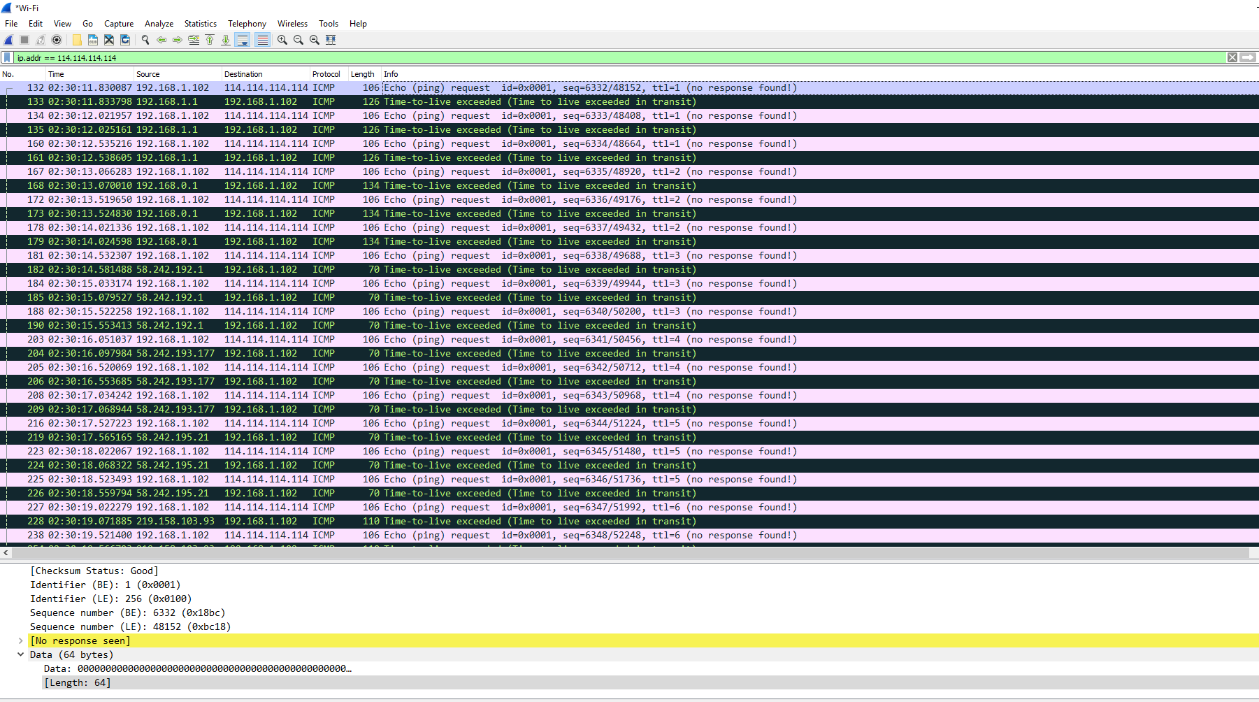

  2. tracert shows request time out for all the hops except the last hop.
    tracert shows request time out for all the hops except the last hop no matter what hostname/ip I am tracing and what kind of network I am using(home, corpnetwork, vpn.) and which city I am in. Ping works fine. They all use ICMP .
    When I try to capture the packets of the tracert process, I CAN see the ip address of the hops tracert was going though. And traceroute command works fine on my Linux virtual machine(using Hyper-V).
    I had tried to reset my computer network, but it is not working.
    Please, anyone has any clues about this issue?
