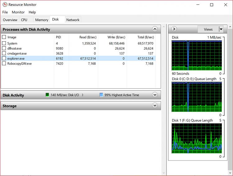

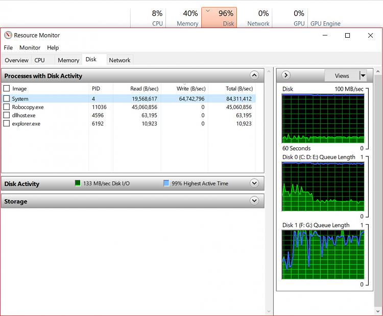

    2 - The reason of priority and capping was revealed to me as on conducting the same experiment with Robocopy (A fast folder copy command line tool suggested by Samuria) , when the system reached its Disk % Utilization peek (95~100%) the system starts becoming slightly unresponsive .
    3 - Now on the other hand Robocopy command despite not running in any higher priority somehow trigger the System to assist it in Reading so the Cap limiting is off (i.e the System Read along with it at the exact capped speed) to render a full Disk % Utilization :
    Transfer rate...really? 208512d1539624002t-need-explanation-odd-figures-copy-transfer-rates-rm2.jpg

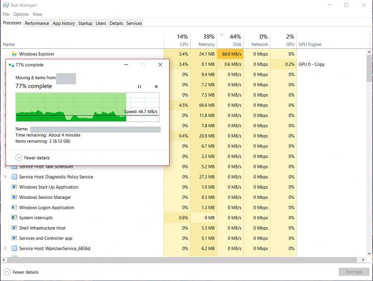

    Ok so basically I am trying to figure why would I get 3 different readings from windows from a file Copy/Move operation , first things first this is an internal SSHD trying to copy files to another internal SSHD both running on a Sata 3 interface .
    Now the remark is I get a fluctuating rate between 70 ~ 35 MB/s reported on Copy/Transfer Dialogue and then exactly double the figure on Task Manager "Disk % Transfer Rate" and Yet less than 50% Cap to "Disk % Utilization" .
    Transfer rate...really? 208466d1539601580t-need-explanation-odd-figures-copy-transfer-rates-sshd.jpg
    Now Maybe but not really sure I can assume that the "Disk % Transfer Rate" doubles figures to portray cumulative disk utilization of both disks . Now why is it still capped under 50% if the Sata interface can take it ? Defragmantation ? Can defragmentation cause a 50% cap ?

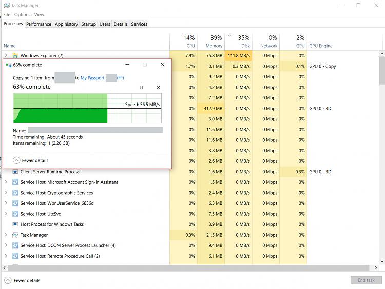

    Which lead me to try it but this time to a USB 3 external HDD and here are the results :
    Transfer rate...really? 208467d1539601768t-need-explanation-odd-figures-copy-transfer-rates-sshd2.jpg
    Again the numbers are doubled in "Disk % Transfer Rate" and while the transfer rate is higher the "Disk % Utilization" is lower , so can anyone confirm why these numbers are all messed up like that ?
