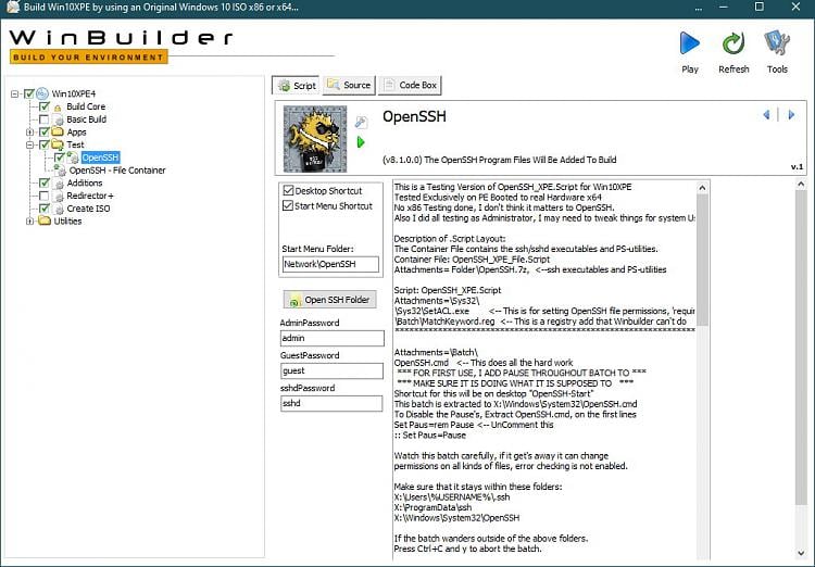

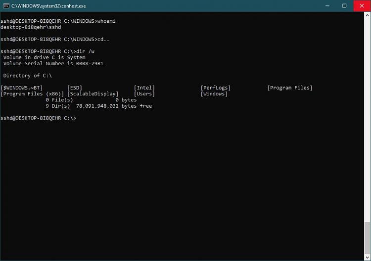

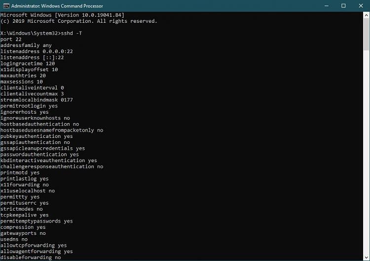

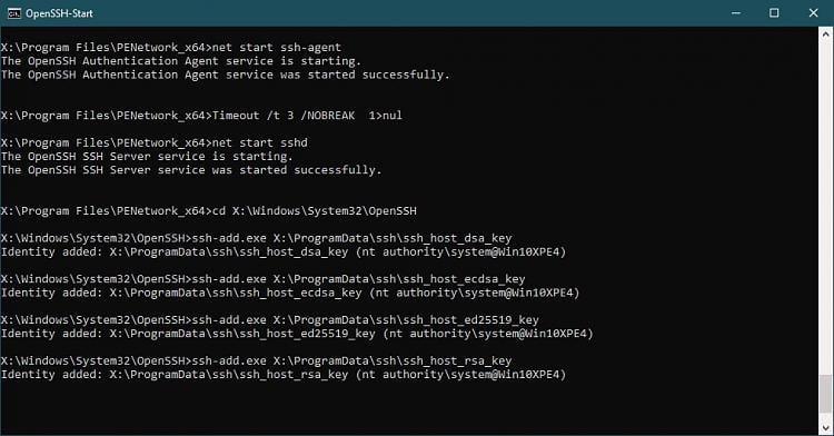

    Win10XPE : How to enable SSH Server with Public Key Authentication
    Since this is the thread that got me started on OpenSSH in Win10XPE I thought it appropriate to post here, thanks for the push. I have a working OpenSSH_XPE.Script and I need some testers. Please PM me.
