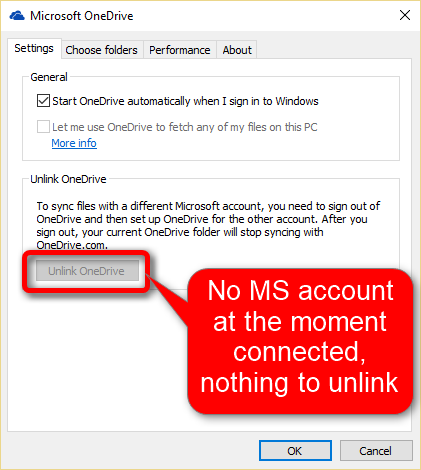

  2. Kari Win User
    Can't sign into OneDrive after switching PC to local account
    The reason the button to unlink is grayed out when you switched to a local account is that there's no account to unlink:

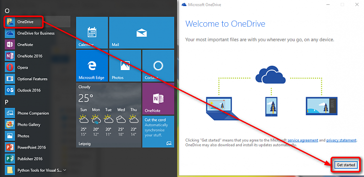

    Your MS account was unlinked the moment you switched to a local account. To link a new or your old MS account, you need to setup OneDrive again. You do this by launching the OneDrive from the Start Menu and then clicking Get Started:
