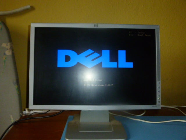

    Dell Inspiron 530
    Windows 7 Home Premium 32bit
    AMD Athlon 64 dual core
    4GB DDR2
    EVGA Graphics Card
    PC showed no sign of powering on,
    Removed graphics card
    Disconnected HDD and DVD/CD ROM
    Tested the power supply unit with multi meter all voltages are OK
    Removed CMOS battery and replaced with new battery
    Replaced the graphics card and connected the HDD and the DVD/CD ROM

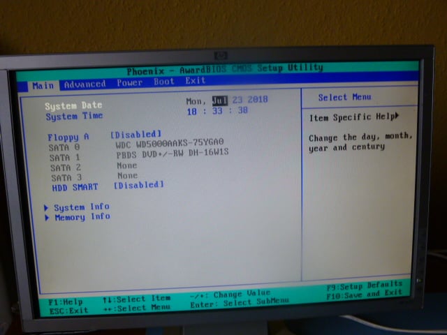

    The pc powered on and could hear the beep as normal, had the message Diskette drive 0 seek failure, went into the BIOS disabled the Floppy A [1.44, 3.5 in.]

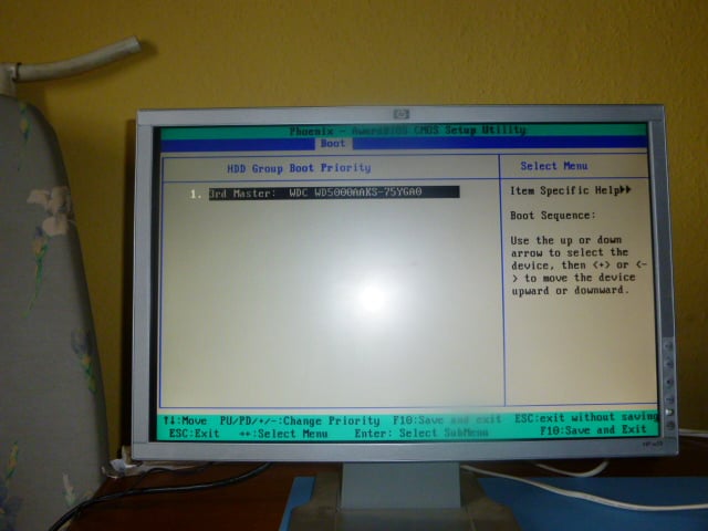

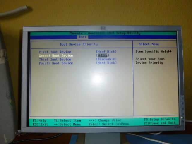

    Set the BOOT device priority to;
    First Hard Disk
    Second CD ROM
    Third Removable
    Fourth Hard Disk although there isn’t a fourth HDD
    I am confused as on the HDD Group Boot Priority it states “1 3rd Master: WDC WD5000AAKS-75YGA0" which is my only HDD that has ever been installed with Windows plus data and applications.

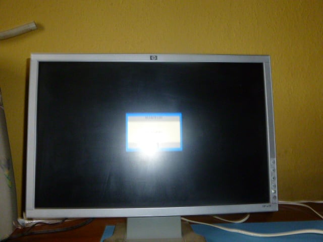

    The problem I have now is that the BOOT sequence goes into a loop and does not load Windows but instead after each loop the screen shows that there is NO SIGNAL and the pc starts again and the splash screen displays but the pc goes into the same loop over and over again with no other message.
    Any help with sorting this endless loop and getting the pc to load Windows would be most appreciated. *Wink
