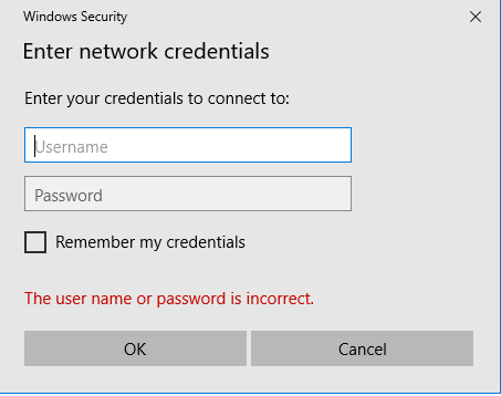

    7 Access the shared drives both ways between each pair of computers & provide network credentials- The first time you do this you will need to enter the common local Admin account username and common password {the one set up on each computer at step 2 above}
    - Set the Remember my credentials checkbox so that you are never required to do this again
    Two computers on local network not fully seeing same shared files 9198d1601177644-share-files-folders-over-network-windows-10-a-network-credentials-called-cleaned.png
