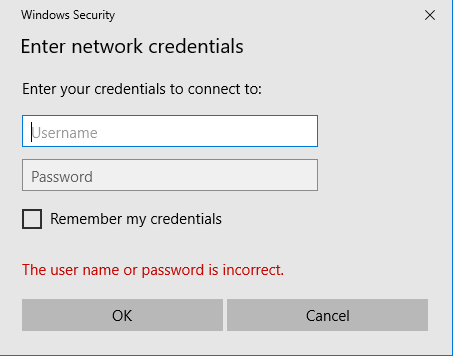

    Computers AAA laptop and BBB desktop are connected to the same local private wifi network.I want to share files between AAA and BBB, in both directions, but it looks like only one direction AAA->BBB is working properly, and the other BBB->AAA isn't.I have checked that the Advanced Sharing Settings in Network and Sharing Center are set the same on both machines. Specifically, network discovery is turned on, file and printer sharing is turned on, public folder sharing is turned on, password protected sharing is turned off, 128-bit encryption is turned on.Here is AAA looking at \\lo

    7 Access the shared drives both ways between each pair of computers & provide network credentials- The first time you do this you will need to enter the common local Admin account username and common password {the one set up on each computer at step 2 above}
    - Set the Remember my credentials checkbox so that you are never required to do this again
    Two computers on local network not fully seeing same shared files 9198d1601177644-share-files-folders-over-network-windows-10-a-network-credentials-called-cleaned.png
