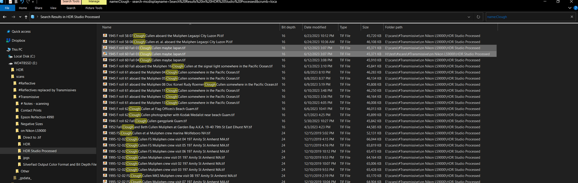

    Here’s what’s wrong – if I rename one of the pair of same-filename images in one of the instances of File Explorer Search results, it immediately is added to the other instance of File Explorer Search results… which is pointing to a completely different drive and pathname. If the Folder Path column is set the results shown in the File Explorer Search results where it incorrectly appears shows the path to the other File Explorer instance Search path! See attached screen capture to see the result.

    Perhaps I am asking the wrong question. See attached image for statement of this issue: File Explorer Search results include files not within folder searched, nor its path, not even its drive.
    Two instances of File Explorer Search results pointing to two different drives and paths -... HRl0f9JOLJhxmVPoLfmbOWQWc8CZ1gG27NIn8pKI%2bf%2f02oJVzEfO8SQq8o7k1mPhDeaIY4zEtvHuIm9HIb%2fCxTc%3d.png

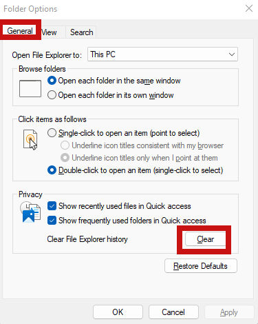

    2. Clear File Explorer History: In File Explorer, go to the "View" tab, click on the "Options" button, and then select "Change folder and search options." In the "General" tab, click on the "Clear" button under the "Privacy" section to clear the File Explorer history.
