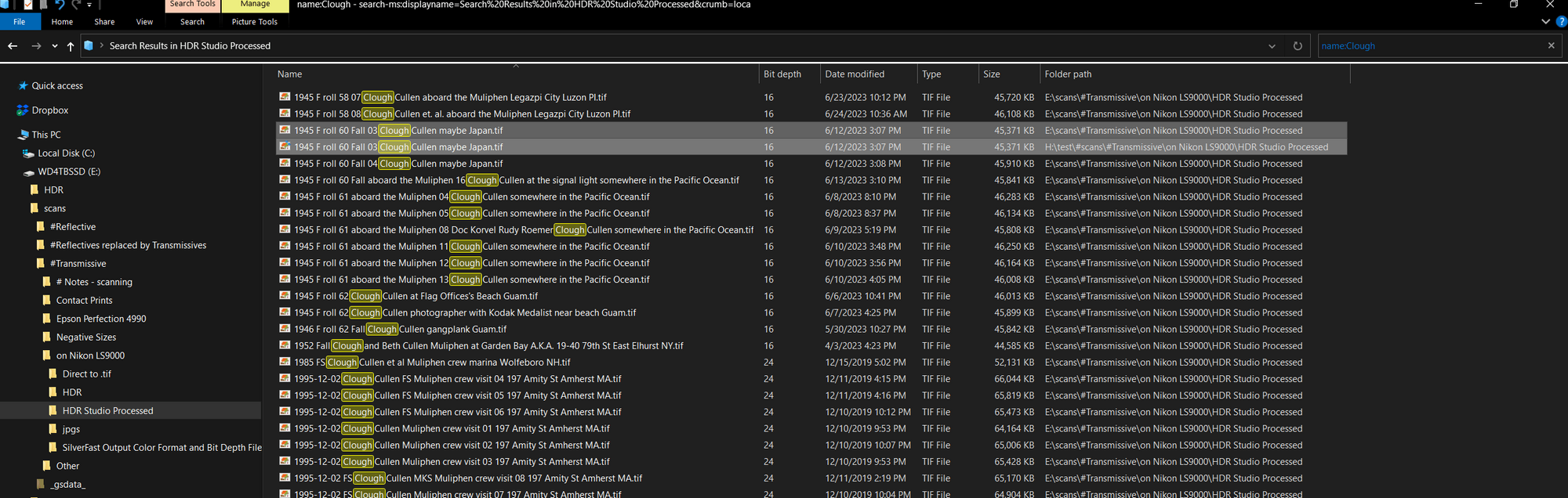

  2. Two instances of File Explorer Search results pointing to two different drives and paths - change a file name in one File Explorer instance Search results spontaneously appears on the other instance.
    Windows 10 22H2 build 19045.3086
    I have two copies of photos on two separate drives, so two distinct paths:
    E:\scans\#Reflective\Wineway\TIF masters
    H:\*******\#scans\#Reflective\Wineway\TIF masters
    I have two instances of Windows Explorer up, with identical Search selections, each pointing to the different drives within the \TIF masters directories. This yields the same set of four filenames, but one of the matching filenames is being used on different pictures on each instance – a mistake I was made aware of when using GoodSync which pointed this issue out to me.
    Here’s what’s wrong – if I rename one of the pair of same-filename images in one of the instances of File Explorer Search results, it immediately is added to the other instance of File Explorer Search results… which is pointing to a completely different drive and pathname. If the Folder Path column is set the results shown in the File Explorer Search results where it incorrectly appears shows the path to the other File Explorer instance Search path! See attached screen capture to see the result.
    So, if the Search criteria I use is NOT identical for each File Explorer instance – yet yielding the same set of filenames – this does not happen. This appears to be a bug in File Explorer’s Search programming.
    JustTryingToGetThingsRight, Jul 15, 2023

    Perhaps I am asking the wrong question. See attached image for statement of this issue: File Explorer Search results include files not within folder searched, nor its path, not even its drive.
    Two instances of File Explorer Search results pointing to two different drives and paths -... HRl0f9JOLJhxmVPoLfmbOWQWc8CZ1gG27NIn8pKI%2bf%2f02oJVzEfO8SQq8o7k1mPhDeaIY4zEtvHuIm9HIb%2fCxTc%3d.png

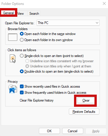

    2. Clear File Explorer History: In File Explorer, go to the "View" tab, click on the "Options" button, and then select "Change folder and search options." In the "General" tab, click on the "Clear" button under the "Privacy" section to clear the File Explorer history.
