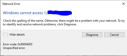

    I have an issue with accessing the shared folders on my Desktop computer from my Laptop A on same network.
    Trying to access my computer with IP address from file explorer with \\<desktop_computer_ip_here> results in following error:
    Unable to Access Shared Files on Local Network after Windows Update 317717d1612557254t-unable-access-shared-folder-specific-computer-local-network-error.png
    This is strange because I am able to access shared folders from my Laptop B and also I am able to access the share from SMB client on Android. Also, Desktop computer is pingable from Laptop A.

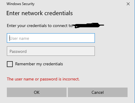

    Strange thing happens if select "Turn on password protected sharing" option in "Control Panel > Network and Sharing Center > Change advanced sharing settings" menu then this login form shows up:
    Unable to Access Shared Files on Local Network after Windows Update 317716d1612559394t-unable-access-shared-folder-specific-computer-local-network-form.png
    But trying to log in with my account results in invalid credentials. (My Desktop Computer does not require password so trying to log in without password results in invalid credentials).

    Resolved the issue by enabling insecure guest logons in Group Policy Editor.
    More info here
