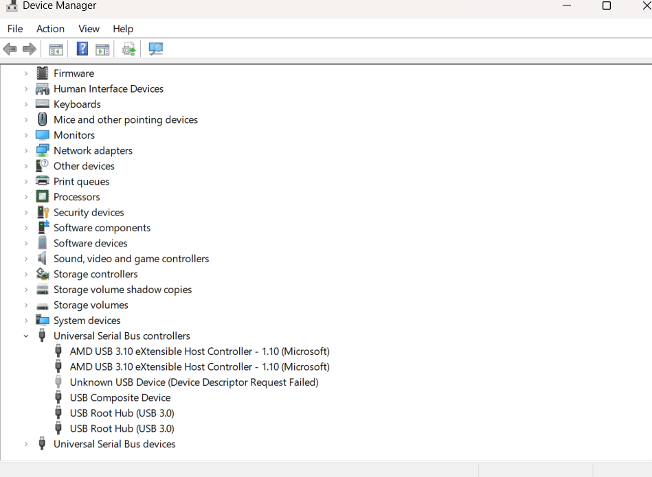

    When connect device first:
    Unable to connect android phone to windows 11 23H2 Laptop via USB cable KyDe8SNIZ9keQU5doNiJHwwrFeNHhwjEF6hreP3WkOfreJ%2BTABkcmRIQpfA6lL8Jj%2BUnroXbBiUZd71hA7ck4ygPk%3D.png

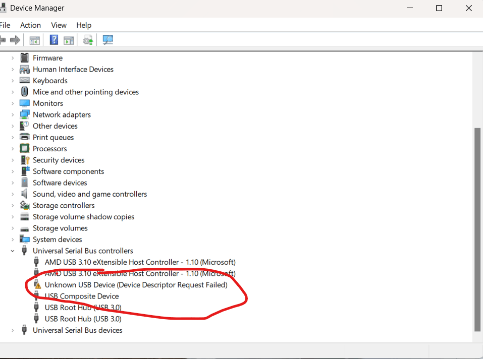

    When i Power off my phone then:
    Unable to connect android phone to windows 11 23H2 Laptop via USB cable ybg5xIAg1EvkHO9EXnAcoZC%2BQQUFSBlW7Atc7BfT5XssqY19VcItEr2EngyksZhwCol1t5orYDDcvFKhDGS2nC8dWsc%3D.png

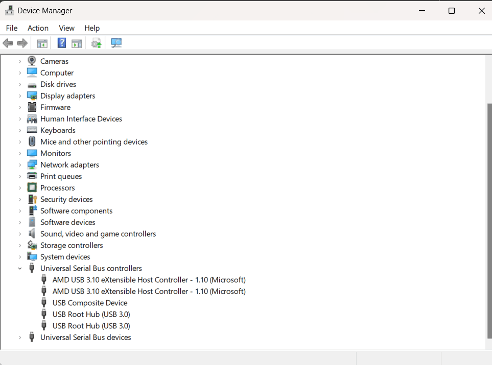

    After power on
    Unable to connect android phone to windows 11 23H2 Laptop via USB cable Y7uXka1sz0yDqz55AuL7ufSxtnUUkXp5aHgMYXjWb37RcMjl0QrXDmBrI%2F%2B6AD%2FS12MyKlWRXrDrQlrtN0NMw5Q%3D.png
    Driver Error code :
    When Device is power on error code is 45
    power off error code is 43.
    AJAYSINH PARMAR, Sep 16, 2024
