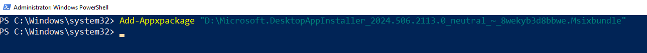

    Hello allI am using Windows 11 and everything is up to Date.I am unable to Install any .msix or .msixbundle Files, I just get a White Window for a Second which then Closes and I get an Error Box stating that the App could not Start.I managed to Install the App using the Command Line which worked fine, however, this is far from convenient and it also further causes Issues as the App is not able to Update as it uses .mix Files which results in the same Issue as described above.I have Run sfc /scannow and no Issues were found.I have also tried to Download the App Installer again, from the Microso

    Please try PowerShell (admin) to install the .msix or .msixbundle file.
    Example:
    • Add-AppxPackage -Path "C:\Apps\MyApp.msixbundle"
