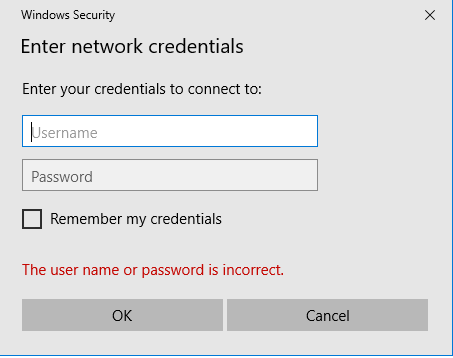

    6 Connect each computer to the router's network and set it up as a Private network - Set Network Location to Private - TenForumsTutorials- This connection step assumes use of Windows defender. If you use different security software then you should check if it requires any additional steps, such as manually approving use of specific network adapters, but I imagine they are all pretty decently automated these days and would at least tell you if they were rejecting a network / network adapter.
    7 Access the shared drives both ways between each pair of computers & provide network credentials- The first time you do this you will need to enter the common local Admin account username and common password {the one set up on each computer at step 2 above}
    - Set the Remember my credentials checkbox so that you are never required to do this again
    Unable to see windows 11 22H2 update computer from other computers on my local network 9198d1601177644-share-files-folders-over-network-windows-10-a-network-credentials-called-cleaned.png
    - You will be able to access the shared drives using all other user accounts not just the Admin account used to set it all up.
