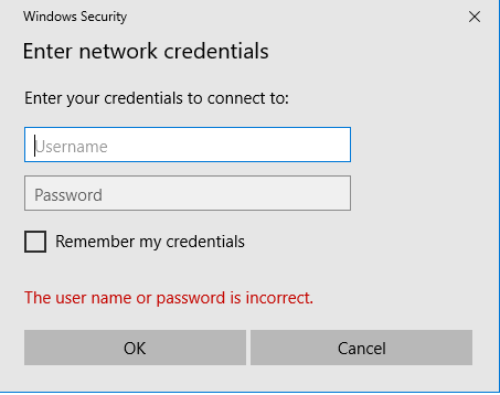

    7 Access the shared drives both ways between each pair of computers & provide network credentials- The first time you do this you will need to enter the common local Admin account username and common password {the one set up on each computer at step 2 above}
    - Set the Remember my credentials checkbox so that you are never required to do this again
    Unable to see windows 11 22H2 update computer from other computers on my local network 9198d1601177644-share-files-folders-over-network-windows-10-a-network-credentials-called-cleaned.png
    - You will be able to access the shared drives using all other user accounts not just the Admin account used to set it all up.
