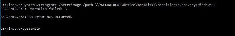

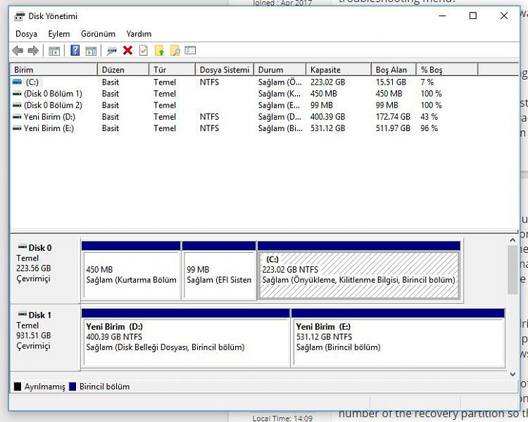

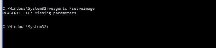

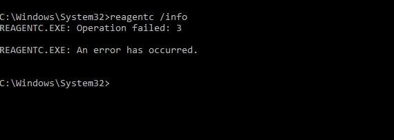

  3. feelulive Win User
    windows 10 no advanced-startup-options, so no startup settings
    Unable to select option in the advanced startup settings F1-F9 152848d1505165150t-windows-10-no-advanced-startup-options-so-no-startup-settings-c.jpg
    Unable to select option in the advanced startup settings F1-F9 152849d1505165150t-windows-10-no-advanced-startup-options-so-no-startup-settings-c2.jpg
    Unable to select option in the advanced startup settings F1-F9 152850d1505165150t-windows-10-no-advanced-startup-options-so-no-startup-settings-c3.jpg
    Unable to select option in the advanced startup settings F1-F9 152851d1505165150t-windows-10-no-advanced-startup-options-so-no-startup-settings-c4.jpg
    feelulive, May 21, 2023

    If you are still unable to see the options in advance startup settings, I suggest you to enable advance startup options using the follow command.
    To do that,
    1. Type CMD in the Windows search bar.
    2. Right click on CMD and click on Run as administrator option.
    3. Copy paste the following command reagentc /enable.
    4. Restart the PC into WinRE mode and check if you able to see the options.
    We await your response.
