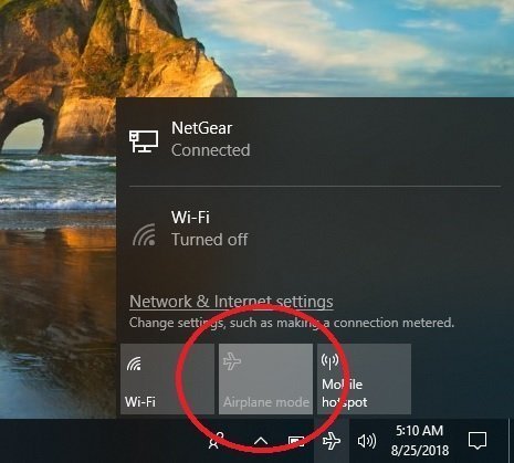

  1. Unable to switch OFF/ON airplane mode.
    dear community i have installed windows 10 in my laptop and installed all drivers, everything was fine. but after updating through internet to latest version of window 10, i am unable to switch off airplane mode, that's why am also unable to use internet through wifi & also unable to use Bluetooth.
    Unable to switch OFF/ON airplane mode. 970b4121-6f1b-45c0-b24d-ae8ab5922530?upload=true.jpg
    MuhammadKashif-bahl, Aug 25, 2018
  2. Airplane mode switch not working
    Since the troubleshooting steps that were provided did not resolve the issue, we suggest switching on the Radio Management Service. To do that, please follow the steps below:
    • Press Windows key + R.
    • Type services.msc, then hit Enter.
    • Search for Radio Management Service.
    • Right-click, then choose Start.
    Note: Never ever set this service to "Disabled".
    Get back to us if the steps won't work.
    Marilou Ser, Aug 25, 2018
