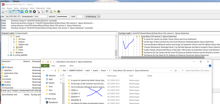

    Long path names (>260) works with some file browsers
    Hi folks
    Some file browsers now work with the long file names but "bog standard file explorer" plus applications based on the old explorer api will still fail. - You set long file names via reg key -- it's in the tutorials.
    Anyway for example FILEZILLA (an FTP client) running on Windows can show correct files on a NAS server. File explorer fails.
    Here's the screenshot
    Unable to truly enable Long Paths >260 chars 269136d1583318434t-long-path-names-260-works-some-file-browsers-longfiles.png

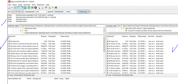

    Files transferred successfully no names lost and can be seen with FILEZILLA on the LOCAL (windows machine) properly
    Unable to truly enable Long Paths >260 chars 269139d1583319152t-long-path-names-260-works-some-file-browsers-longfiles2-png.png

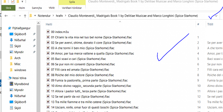

    After transfer the files can still be viewed correctly also in File explorer because the path length is shorter than 260 but it's a start to at least transferring files with long path names from a NAS server to windows. Files also play correctly.
    Unable to truly enable Long Paths >260 chars 269140d1583319420t-long-path-names-260-works-some-file-browsers-longfiles3.png
    Note : the basic problem is that the path name on the NAS server could well be quite long -- this NAS server has 20TB of HDD on it - around 4 - 5 TB of music. The destination path on windows won't include the whole NAS path length but you probably want the folder and music files which will pretty well always be <260 chars in path name lengths)
    File explorer breaks down if you merely use it for copying these files vis "Connect Network drive" as it can't display the NAS directory properly as shown.
