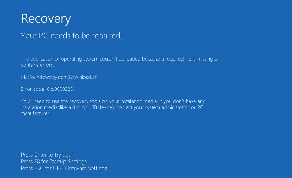

    As many did, I upgraded my ASUS G751JY from Windows 8.x to Windows 10, and this destroyed ASUS F9 built-in recovery feature. When I press F9 now it will give me a BSOD with:
    Your PC needs to be repaired
    A required device isn't connected or can't be accessed.
    Error code: 0xc0000225
    [ A text saying I should use recovery tools on my installation media to fix the issue. ]
    Press Enter to try again
    Press F8 for Start-up Settings
    Press Esc for UEFI Firmware Settings
    This happens every time I want to use F9, then every time I have also to repair Windows boot (have no problem, I know how to do this and regenerate a correct BCD), so my idea now is to recreate a generic Windows 10 install partition working with ASUS F9 feature.

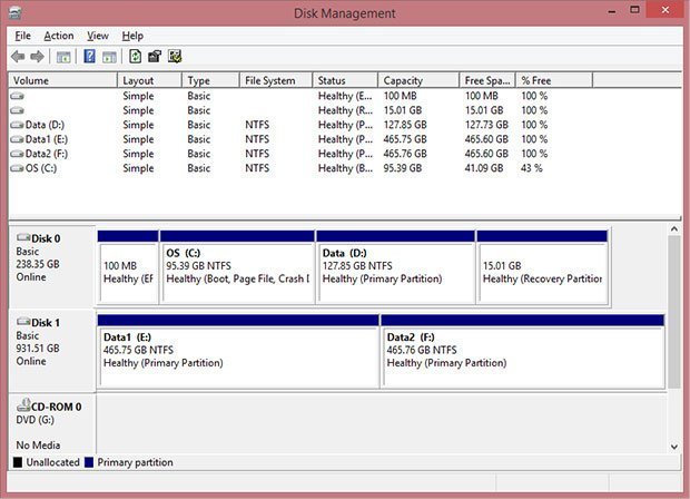

    Here is my current situation:
    Unable to use ASUS recovery partition, f9 is not working [​IMG]
    but Recovery partition was Disabled.

    ...but unfortunately ASUS F9 still doesn't work as expected () and returns the usual BSOD Error 225 mentioned in first msg *Sad
    Mmmh... I start to think F9 simply works by booting from the first Recovery partition it can find, usually put after C: on ASUS G751JY laptops as shown in this example pic coming from an online review:
    Unable to use ASUS recovery partition, f9 is not working small_G751JY_partitions.jpg
    Probably it expects to find something more than the install.wim file there as it asks for winload.efi pressing F8 after BSOD is displayed:
    Unable to use ASUS recovery partition, f9 is not working winload-efi-0xc0000225-windows-8.jpg
