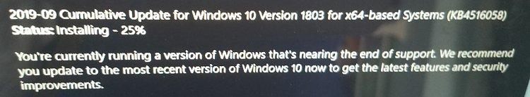

  2. klein5366 Win User
    win10 18.03 failed install 0x80073712
    good day all
    my child hasn't been keeping up with windows up dates and there was a hickup .
    my child has a laptop with no cd/dvd dis player, so i'm tring to use a usb key with Win10_1903_V1_English_x64.iso image installed with Rufus.
    the computer has installed all updates listed except :
    Update KB5031445 fails to install. Error 0x80073712 248119d1568986645t-win10-18-03-failed-install-0x80073712-screenshot-2019-09-20-09-09-47.png
    then i get this :
    Update KB5031445 fails to install. Error 0x80073712 248120d1568986843t-win10-18-03-failed-install-0x80073712-screenshot-2019-09-19-21-05-16.png

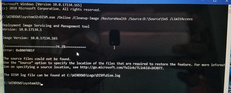

    error: 0x80073712
    witch leads me to running this command to fix :
    DISM.exe /Online /Cleanup-Image /RestoreHealth /Source*Biggrin:\Source\SxS /LimitAccess
    D:\Source\SxS = usb Win10_1903_V1_English_x64 installed on key with Rufus.
    when the above line DISM.exe /Online /Cleanup-Image /RestoreHealth /Source*Biggrin:\Source\SxS /LimitAccess is ran as admin i get this :
    Update KB5031445 fails to install. Error 0x80073712 248121d1568987029t-win10-18-03-failed-install-0x80073712-screenshot-2019-09-19-21-07-49.png
    right now i'm downloading :
    Win10_1809Oct_v2_English_x64.iso
    but the version in the admin terminal says 17.134.165 so i'm not sure this is going to help me ?
    im not sure what to do to correct this problem, i do have the CBS.log and the dism.log i can post .
