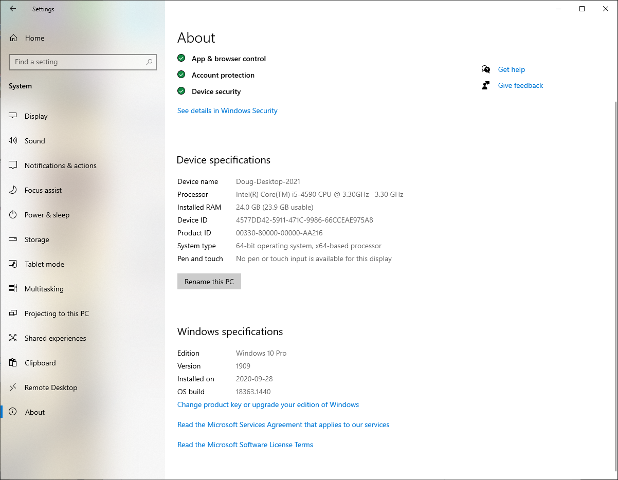

  1. Update to Win 10 2020--VMware Workstation Glitch
    Attempting to update to Win10 2020
    Get the following error message 25% into installation:
    _P0_VMware Workstation Pro Mo-Op
    Uninstall this app
    I have uninstalled the app but the error message continues to interrupt my installation.
    Any ideas>
    Update to Win 10 2020--VMware Workstation Glitch 77527ac5-dd18-447d-a293-b1624e11d66b?upload=true.png
    DouglasDrake1, Mar 13, 2021
