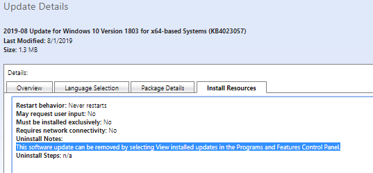

    Update KB4023057 is not Compatible with Windows 10.0 18363.476 (1909) and USB-C Dock using an External Monitor
    After updating to Windows 10.0 18363.476 Version 1909 I noticed that an External Display Monitor connected via a DELL D6000 USB-C Dock did not wake up after power shutdown and a fresh restart as intended. I noted an update KB4023057 which was listed as installed
    in Windows settings -> apps and features. It was for an older Windows 10.0 Version 1803. So, I decided to uninstall it. After it was uninstalled, the External Display Monitor now wakes up after restart from a powered down condition or sleep function. I suspect,
    since the update was installed with apps and features, instead of with Updates and Security it was overlooked for removal by the latest Feature Update to Windows 10.0 Version 1909.
    update to Windows version 1909 connecting to external display d78d1ace-a40f-4bbc-b5bc-030f98a2f910?upload=true.png
