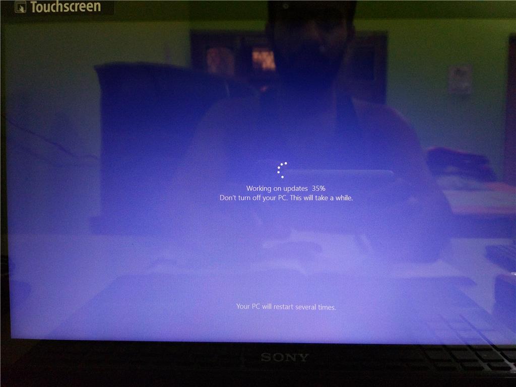

    Windows 10 anniversary update stucked on 35% while working on updates
    I am using a sony laptop running on windows 10 version 1511. And i tried to update the windows to new version build 1607 twice but both the time it got stucked at working on updates window at 35%. There hasnt been any update failure before on my pc.
    Update version 20h2 stuck at 35 percent d755a5d6-e2d4-4c6c-abee-85eef6ac2db4.jpg
    Can you suggest a way to install the new update successfully.
