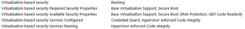

    In our domain, our computers are set up to have Credential Guard enabled with UEFI lock. This has been working without issue. I noticed on one computer (running Windows 11 22H2, latest build) that Credential Guard shows as not running in in System Information:
    Updated BIOS, and Credential Guard MAY not be running anymore AOVz%2fct1%2bp36FrESbhn5FWFnbVA3Ts6SIza%2bK3kjmpTsJag0oRd48bA064H%2b2QtxtGIE051UrUNa3FUceyBxw%3d.png
    Trying to determine why Credential Guard isn't running, I looked at the event logs only to find that they report it started without issue, after reboot, Wininit Event ID 13 appears with the following message: "Credential Guard was started and will protect LSA credentials."
    This computer was running credential guard before without issue, I don't know what changed and why it claims to not be running anymore. Other computers in our environment that are identically configured (hardware and software) are running Credential Guard without issue. There are no Credential Guard related events at any time that imply it has failed to start. Only this event 13 showing it is started and running.
    Any idea what is going on here? Is there a way for me to confirm the status of Credential Guard given the conflicting information shown above?
    Alex Rourke, Sep 7, 2023
