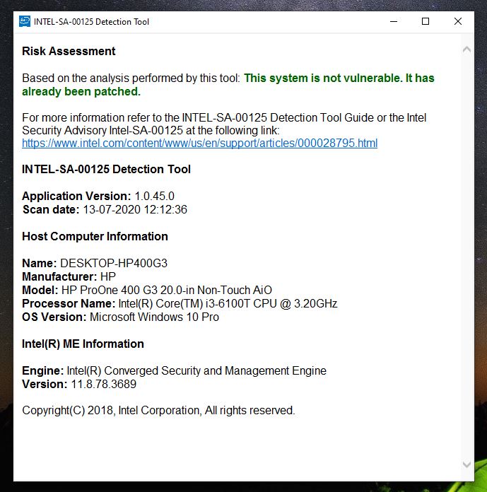

  1. Updated INTEL Management Engine Firmware v 11.8.78.3689 Dated 09-07-2020 without problems...
    My College have HP PROONE 400 G3 20.0 INCH NON-TOUCH AIO PC withHP P13 System Firmware 02.34 bios with Intel i3 6100T Processor and with integratedIntelR HD Graphics 530 GPU.
    On 13th June 2020, I updated Intel Management Engine firmware v11.8.78.3689 on top of existing firmwarev11.8.78.3681 on Windows 10 2004 Professional 64bit build no 19041.329
    Moreover, I enabled spectra vulnerability fix by registry keys. Those registry keys are available in support.microsoft.com.
    I have taken the high risk for updating the latest firmware and drivers because of intel identified the vulnerabilities in management engine
    I am not recommending users to update without consulting laptop or desktop or motherboard HP Support
    Ask your system manufacturers for the released new ME firmware.
    There are different types of firmware depends upon the intel processors generation and the for respective SKU's only.
    This Intel Management Engine Firmware directly updates the intel processors and will be lifelong. Future updates only can be installed if existing firmware is not corrupted or not modified
    Downgrading firmware is not available, so I won't recommend it.
    Be careful before updating the new firmware, please note I and below site users and admin are not responsible for damaged caused due to updating.
    Incorrect firmware will damage the processors. Even it won't boot or laptop won't power on.
    This firmware is not available on the HP support website for PROONE 400 G3 20.0 INCH NON-TOUCH AIO PC. I took a risk and updated by own.
    After updating Desktop is running without problems, NO BSOD ,NO driver incompatibility
    I downloaded Intel Management Engine Firmware from below website
    https://www.station-drivers.com/index.php?option=com_remository&Itemid=352&func=fileinfo&id=4522&lang=en
    Thanks for reading my post. If you like means then give UPVOTES to me.
    Updated INTEL Management Engine Firmware v 11.8.78.3689 Dated 09-07-2020 without problems... 0616ec9b-3e3b-4e0f-bb49-2f9a6c3e9a7e?upload=true.jpg
    RAJU.MSC.MATHEMATICS, Jul 13, 2020

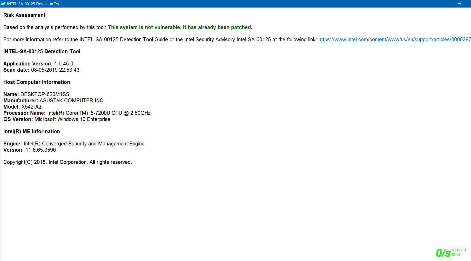

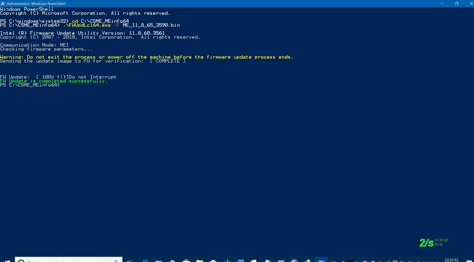

  3. UPDATED INTEL MANAGEMENT ENGINE FIRMWARE 11.8.65.3590 DATED 08-05-2019 ON ASUS R542UQ-DM153 WITH INTEL I5 7200U WINDOWS 10 1809_17763.475
    On 08-05-2019 , i updated Intel Management Engine firmware Version 11.8.65.3590 on windows 10 64bit 1809_17763.475.
    Also i updated Intel Management Engine Firmware v11.8.60.3561 last year.
    Moreover i enabled spectra vulnerability fix by registry keys. Those registry keys are available in support.microsoft.com.
    I taken high risk for updating latest firmwres and drivers because of intel indentified the vulnerabilities in maanagement engine
    I am not recommending users to update without consulting laptop or desktop or motherboard manufacturers .
    Ask your system manufacturers for release new ME firmwares.
    There are different types firmwares depends upon the intel processors generation
    This Intel Management Engine Firmware directly updates to the intel processors and will be lifelong .Future updates only it relaces . Downgrading firmware is not available .
    Be careful before updating , I and below site users and admin are not responsible for damaged caused due to updating.
    Incorrect firmware will damage the processors . Even it won't boot or won't on .
    This firmware is not available in oem manufacturers site . I took risk and updated by own
    Intel Management Engine: Drivers, Firmware & System Tools
    source taken Win-Raid Forum (Drivers - Firmware - Modding)
