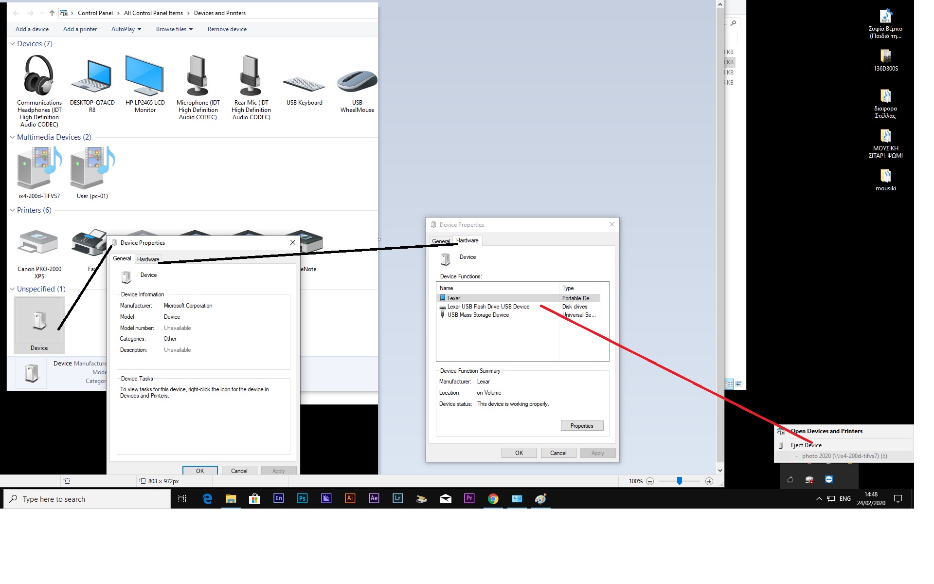

  4. USB 2.0 devices do not work in a USB 3 slot Win10 21H1
    both USB 3 slot - front -in my PC Not read USB STICKS either 3.0 or 2.
    if go in my other PC USB 2 slots and insert USB stick this is read without problems either 3 or 2 USB stick
    see screenshot
    nothing appear in safety remove
    what to do to read USB sticks???? in the picture connected USB 3 to USB 3 hub to USB 3 slot in PC - again Not seen, well????
    i think this is from time upgraded to Win 10 pro from win 7 pro
    USB 2.0 devices do not work in a USB 3 slot Win10 21H1 00e3604e-c488-4b52-b828-daf402ca672f?upload=true.jpg
    AndreasGeorgiou2, May 2, 2021
