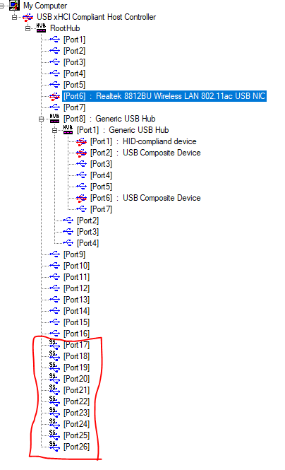

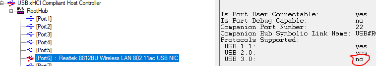

    I have a Realtek wireless adapter, which is labelled as a USB 3.0 device, connected to a USB 3.0 port but I'm getting the message: "Device can perform faster when connected to USB 3.0"
    I have read multiple posts and tried many steps, including:
    - Uninstalling/Updating the device driver
    - Uninstalling/Updating the USB 3.0 controller
    - Updating Windows 10
    - Reviewing BIOS settings
    One interesting thing comes from the usbview program. Notice that "Supported Protocols" is NO for 3.0:
    USB 3.0 message "Device can perform faster when connected to USB 3.0" a951408e-880a-483b-9011-b2e4193f40d9?upload=true.png
    Also, all the USB 3.0 ports (circled in red) don't appear to be connected:
    USB 3.0 message "Device can perform faster when connected to USB 3.0" 3afff004-3ee3-4e44-8d18-84319f9ccdee?upload=true.png
    J. Randall, Mar 15, 2021
