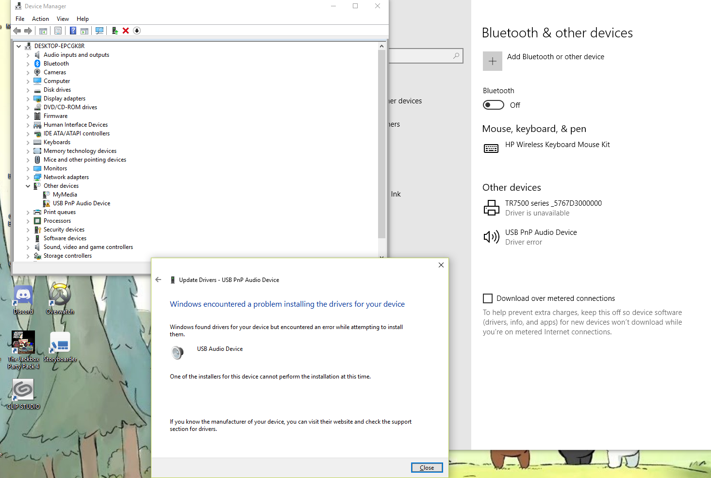

    I recently received a new microphone that is plugged in via USB, unfortunately the drivers refuse to install, every time I go to update the drivers it says an error has occurred. I've restarted my computer countless times and updated all the things I possibly could. I know the microphone is not defective because I tested it out on my Lenovo laptop and it worked, but for some reason the microphone doesn't want to work on my HP Pavillion All In One. I've been trying everything I can to figure out what it is on my computer that isn't working properly. Any help would be appreciated. I added a screenshot of the errors.
    USB Audio Device Not Functioning bf7e40f0-f3e8-4a7d-8d6b-1127d65c36e8?upload=true.png
    BreeC, Dec 3, 2018

  4. Aceman.au Win User
    Sennheiser GSP 350. Microphone stops working when I open any game
    Wow, ok. I think I've fixed it by accident while fiddling around.
    It appears to be the Realtek audio being the issue here. I don't use my onboard sound card as my headset is a USB headset only and my speakers are plugged into an ASUS sound card.
    Step by step fix:
    • I went into recording devices
    • I enabled STEREO MIX (Realtek High Definition Audio)
    • Then I set that Stereo Mix as the DEFAULT DEVICE (At this point it took over both input and output devices without my permission )
    • Then set my Sennheiser headset as default recording and playback devices in their respective windows even though they both still said they were the default devices when they weren't
    Headset microphone is currently functioning while in game now. I'll update the thread if it goes again. Should I completely disable Realtek audio??? Or will windows just force it to work again?
    Aceman.au, Dec 3, 2018
