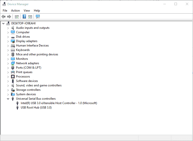

  1. USB ports not working, No power delievery.
    The wires i used and the devices used work well with everything else.
    Except 2 ports on the back with a power sign, none of the 6 other ports do not work.
    USB ports not working, No power delievery. e46ec1d1-66a5-4587-af31-1d0d80ba1cc6?upload=true.png
    I tried everything i can find online. No progress.
    The ports used to work till yesterday. Also, I'd be seeing this "Power surge on USB" error even if i pull out all the USB peripherals incl. keyboard and mouse.
    Additional info: The one of the wires i use to connect has a light which doesn't light up when connecting to any of the 6 other ports which do not have a power button symbol on them and the ports which have power button symbol work just fine.
    System : DELL Optiplex 3040.
    Looking for a fast reply. Thanks in advance!

  4. Mark Ole Win User
    USB ports
    Hi Frank,
    Inserting and removing a USB device repeatedly may cause the USB port to stop responding. When the port is in this state, it no longer recognizes any USB device, and the USB device will not work.
    Here are few things that you can do to resolve the issue:
    Use Device Manager to scan for hardware changes. After your computer scans for hardware changes, it might recognize the USB device that is connected to the USB port so that you can use the device.
    To scan for hardware changes, follow these steps:
    • Click Start, and then click Run.
      Note If you are running Windows Vista, click Start, and then use the Start Search box.
    • Type devmgmt.msc, and then click OK. Device Manager opens.
    • In Device Manager, click your computer so that it is highlighted.
    • Click Action, and then click Scan for hardware changes.
    • Check the USB device to see whether it is working.
    Turn off Allow the computer to turn off this device to save power.
    • In the Device Manager dialog box, expand Universal Serial Bus controllers, right-click USB Root Hub, and then click Properties.
    • In the USB Root Hub Properties dialog box, click the Power Management tab. Uncheck the
      box.
    Let us know how it goes after performing the suggested troubleshooting steps.
