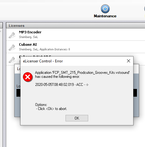

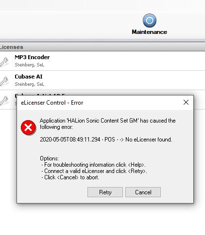

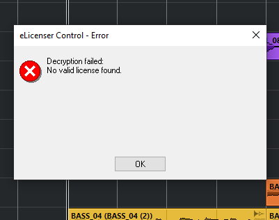

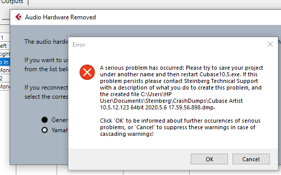

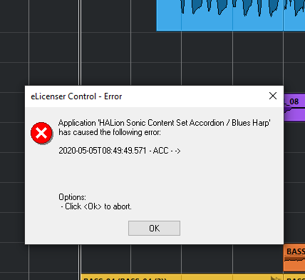

    When I open Cubase by Steinberg, I have the eLicenser, UR12 audio interface and Korg mini keyboard plugged in. Many attempts and many errors and crashdumps.
    I hear the usb sound of disconnecting. The eLCC looses connection and the program can't confirm eLicenses. Program crashes, freezes, or just closes on it's own.

    Previously, I have tried:
    Device Manager, uninstall all USB controllers, restart
    Device Manager, deselect power control of usb ports and Human Interfaces as well.
    Turn offtemporarily anti virus
    computer audio, I select internalto not share external audio interface
    changed advanced power settings for USB, USB suspend settings
    DISM: exe/online/clean-up/restorehealth---sfc/scan now
    Also using a USB self powered hub
    After months of struggling with this, I re-installed Windows 10, Steinberg Cubase and still disconnecting USB ports.
    Steinberg techies have exhausted all ideas.
    Hope you have something else that will work.
    Thanks,
    Jim Barrett
