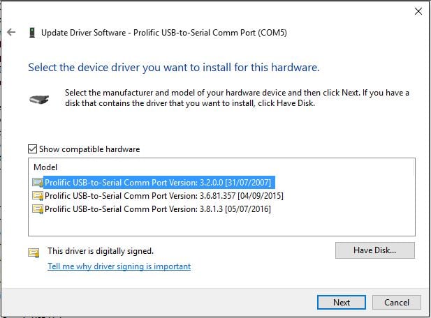

    Have now got things working in a rather 'round-about' way.
    I have 2 USB - Serial Interface cables.
    1. The older which used to previously work on Windows 10 still works OK on a Windows XP Laptop proving that the interface is still functional.
    2. The newer interface cables when connected to Windows 10 automatically installs the drivers & works on Windows 10, but will not work on Windows XP (I don't have a driver disk for this cable but it is CH340 v3.4.2014.8)
    3. If I uninstall all relevant drivers, then install my original Vista Driver v3.2.0. & plug in the interface cable, Windows 10 will then update drivers BUT with Code 10 error. If I now update drivers back to v3.2.0.0 it works & I have a singe interface cable that works on both Windows 10 & Windows XP
      USB SERIAL CH340 CHIPSET NOT WORKING AFTER Windows 10 KB5046613 and KB5046542 UPDATE 93595d1485970009t-prolific-usb-serial-updatedriver.jpg
      However, when I unplug the cable & re-insert, Windows 10 will automatically update the drivers to the NON-Working ones & I have to then re-select the v3.2.0.0 ones every time.

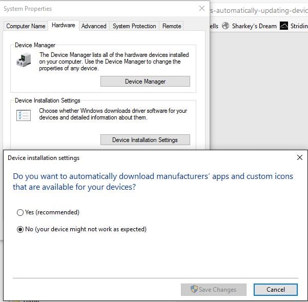

      Is there a way to stop Windows 10 from updating these drivers every time the cable is inserted?
      I've tried changes the System settings for updates but without success.
    USB SERIAL CH340 CHIPSET NOT WORKING AFTER Windows 10 KB5046613 and KB5046542 UPDATE 93597d1485970009t-prolific-usb-serial-settings.jpg
