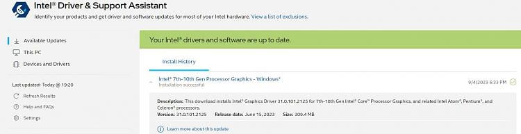

    Thank you @ubuysa Great suggestion, and that's exactly what I did a couple days ago. The assistant gives a clean bill of health with all drivers up-to-date:
    VIDEO_ENGINE_TIMEOUT_DETECTED 141 and VIDEO_TDR_FAILURE 116 while playing 397145d1694169863t-bsod-code-116-141-cpu-replacement-needed-intel.jpg
