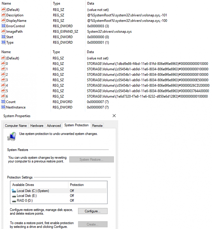

  2. oxonsi Win User
    "Shadow Copies of volume C: aborted" (Event ID 36)...
    I did not see anything obviously wrong with my registry entries for volsnap and enum. Below are screen clips of registry and my system properties showing protection off for all drives.
    Let me know if you see anything "off" that I may have missed. My next step will be to follow the instructions from the support forum...
    Thanks!

  3. oxonsi Win User
    Thanks for the replies and information.
    Yes, I do have Paragon ExtFS for Windows installed. It allows read / write to the ext4 file system from within Windows. I don't use it all of the time, but it installs a ParagonMounter service, which is set to automatic startup by default. The program won't work if ParagonMounter service is set to manual.
    I guess that could then be the cause for the origin of the aborted shadow copies?, as well as my abnormal System Protection settings.
    If that's the case, I'm not too worried about it. I don't feel a need for the shadow copies. My original intent was to address the Event ID 36 by either removing the "user imposed limit" it referenced, or disabling the shadow copies.
    At this point, is there anything more I should do? I guess I could just safely ignore any Event ID 36 errors in the Windows System Event Viewer logs.
