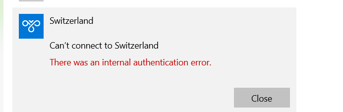

    Ikev2 VPN Internal authentication error
    Hi everyone,
    I have windows 10 pro 20H2,
    I have a problem with my Nordvpn protocal IKev2/IPsec as you see in screenshot.
    VPN ikev2: Error 798 "A certificate could not be found that can be used with this... 311975d1608803990t-ikev2-vpn-internal-authentication-error-internal-error.png
    Sometimes when I want to connect with Ikev2 it gives error named: Internal authentication error. But just after using browser or restarting pc ,the error get fixed and when I connect it then it connected (see picture).
    VPN ikev2: Error 798 "A certificate could not be found that can be used with this... 311976d1608804125t-ikev2-vpn-internal-authentication-error-connected.png
    I tried IKev2 of protonvpn free by installing its certificate and its work fine when ever I connect it,it always connect but nordvpn not. I tried connecting nordvpn just after disconnecting nordvpn but no success.
    I also tried different locations & countries but all have same issue.
    Please tell me why there is authentication error ,how I fix it and whether its windows ikev2 problem or nordvpn ,I followed their full tutorial to install ikev2 from nordvpn and this problem occur everytime even after clean install windows so I have to wait sometime before successfully connecting to VPN
