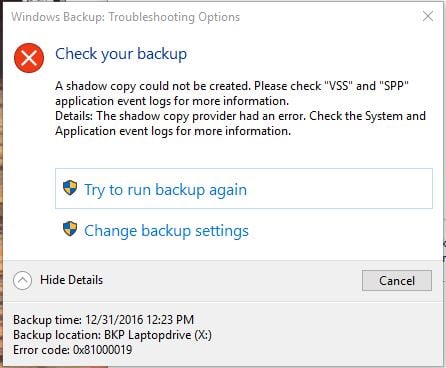

    Get the following error:
    VSS based backup operations windows 7 Backup not working Error 0x81000019 115483d1485975371t-windows-10-backup-failure-error-code-0x81000019-backuperror1.jpg

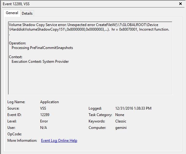

    Also see lots of errors in the event viewer about VSS issues
    VSS based backup operations windows 7 Backup not working Error 0x81000019 115484d1485975371t-windows-10-backup-failure-error-code-0x81000019-backuperror2.jpg
    Attaching event viewer export:

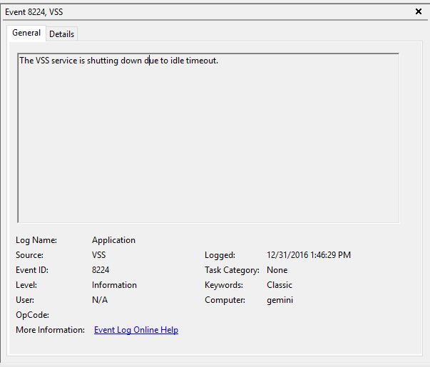

    Interesting one is the volume shadow copy service times out and then stops:
    The VSS service is shutting down due to idle timeout.
    VSS based backup operations windows 7 Backup not working Error 0x81000019 115486d1485975371t-windows-10-backup-failure-error-code-0x81000019-backuperror3.jpg
    I have to start the volume shadow copy service manually after.
    I've tried:
    "Clean Boot" - How to perform a clean boot in Windows - Microsoft Support
    disabled startups and non ms services - no change
    Tried a sfc /scannow - which reported no errors
    chkdsk reports no errors
    It talks about low disk space in one of the event viewer entries but there is 40GB free
    Any help would be appreciated.
    Thanks.
