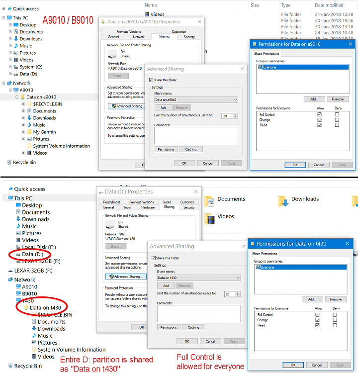

    Here's a description of the three systems involved:
    I have three Windows 10 PCs: two identical Dell 9010 desktops (named A9010 and B9010) and a Lenovo T430 laptop. All three systems are installed with installs of Windows 10 Pro 64-bit 1709.
    None of the systems were set up with a Microsoft account during install - they were all set up with a 'local' account.
    Each system has a data-partition (D:, labelled "Data"), which I have shared, giving full access to 'Everyone':
    (Note: any settings shown for A9010 are exactly the same for B9010)
    W11 Pro laptop - SOHO network multiple sharing problems 174878d1517388116t-network-sharing-problem-between-desktops-laptop-data_share.png

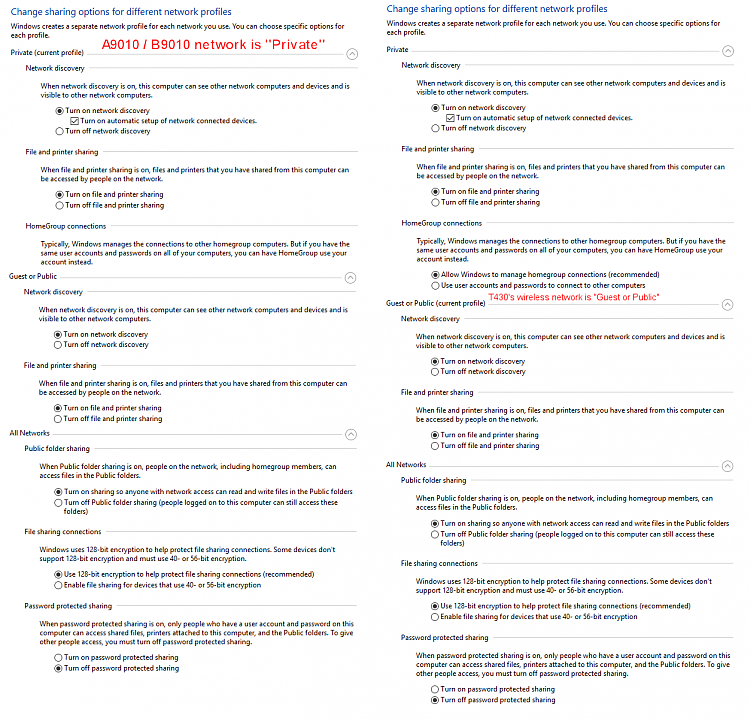

    In the Network and Sharing Centre, I have all three systems set up the same. Password protection is off, file and print-sharing is on, network discovery is on:
    W11 Pro laptop - SOHO network multiple sharing problems 174879d1517388596t-network-sharing-problem-between-desktops-laptop-network_settings.png

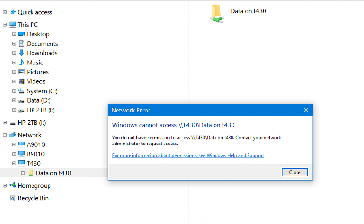

    In Windows Explorer, under the 'Network' entry in the side-pane, all three systems are visible to each other.
    However if I click on the 'T430' share from either of the desktop PCs (A9010 or B9010), I received the following error:
    W11 Pro laptop - SOHO network multiple sharing problems 174880d1517388084t-network-sharing-problem-between-desktops-laptop-a9010_t430_error.png

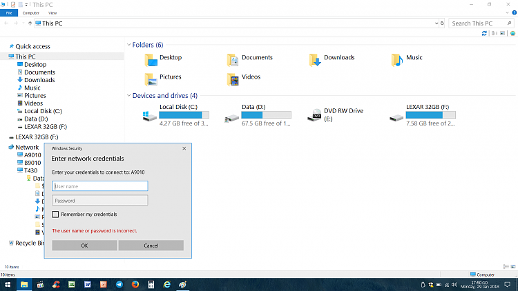

    From the T430 laptop, if I click on either the 'A9010' or 'B9010' share, I receive the following 'Enter Network Credentials" requester:
    W11 Pro laptop - SOHO network multiple sharing problems 174881d1517388058t-network-sharing-problem-between-desktops-laptop-t430_a9010_error.png
    I've tried every imaginable combination of username/password and everything is rejected.

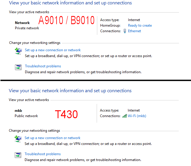

    Looking at the network information for each of the systems, the only thing that stands out is that in the Basic Network Information settings, the two desktop PCs are showing "Private Network", while the T430 laptop shows "Public Network". Not sure if this is relevant, or not:
    W11 Pro laptop - SOHO network multiple sharing problems 174882d1517388618t-network-sharing-problem-between-desktops-laptop-network_info.png
    As ever, I'm grateful for any and all suggestions or comments in my search for a solution to this (very) annoying issue.
