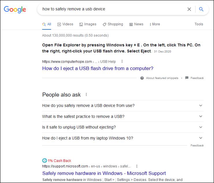

    Are USB ports configured for quick removal?
    How to Never “Safely Remove” a USB Drive Again on Windows 10
    Conversely:
    Have you tried using 'Safely Remove'?
    This should let you discover if there are still programs configured to access the device- if any process is still active and locking it.

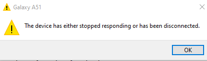

    I think I may have asked this about another android phone. Now I get this popup:
    Warning message: the device has either stopped responding or has been disconnected 369902d1656453030t-device-has-stopped-responding-message-comes-up-device.png
    Even though the device has been disconnected for at least a day.
    How to stop this? Last time I got many popups, like 10.
    Thanks.
