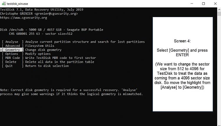

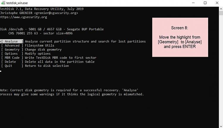

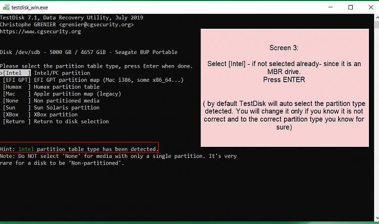

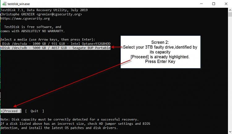

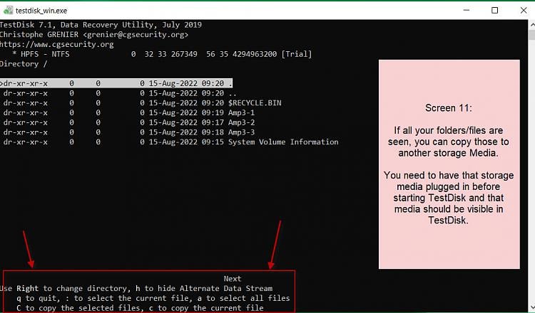

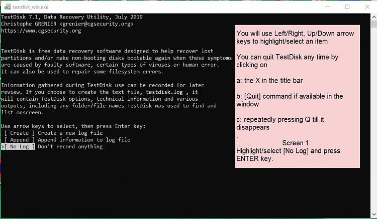

    3 TB WD External Hard Drive NOT Working [ RAW ]

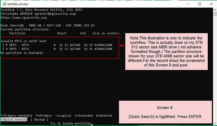

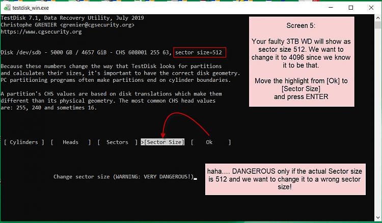

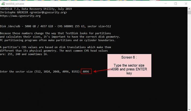

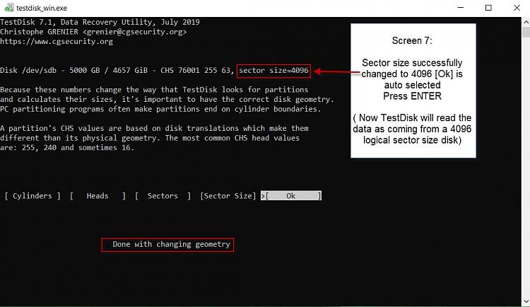

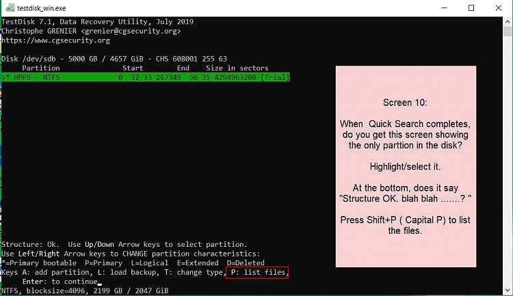

    @Paul Black Please plug in only your faulty 3TB WD drive. ( safely remove all other USB connected storage media.) When you run TestDisk you will then see only your system disk and the faulty 3TB WD. You will run testdisk_win.exe in the testdisk-7.1 folder. ( You may create a shortcut on the Desktop) TestDisk has to be run with admimistrator privileges. Run as administrator. The following screenshots illustrate the work flow. If at anytime you get a screen different from what is shown or you need any clarification, stop, take a screenshot, quit TestDisk and post the screenshot. You can rerun TestDisk later.. Screen 1:
    WD EXTERNAL DRIVE WORKED ON WINDOWS 11 BUT AFTER CONNECTING TO ANDROID DOES NOT WORK WITH... 373258d1660552242t-3-tb-wd-external-hard-drive-not-working-raw-a15-08-2022-09-35-24.jpg
    Screen 2:
    WD EXTERNAL DRIVE WORKED ON WINDOWS 11 BUT AFTER CONNECTING TO ANDROID DOES NOT WORK WITH... 373259d1660552242t-3-tb-wd-external-hard-drive-not-working-raw-b.15-08-2022-09-54-58.jpg
    Screen 3:
    WD EXTERNAL DRIVE WORKED ON WINDOWS 11 BUT AFTER CONNECTING TO ANDROID DOES NOT WORK WITH... 373260d1660552242t-3-tb-wd-external-hard-drive-not-working-raw-c15-08-2022-10-14-07.jpg
    Screen 4:
    WD EXTERNAL DRIVE WORKED ON WINDOWS 11 BUT AFTER CONNECTING TO ANDROID DOES NOT WORK WITH... 373261d1660552242t-3-tb-wd-external-hard-drive-not-working-raw-d15-08-2022-10-54-08.jpg
    Screen 5 : :
    WD EXTERNAL DRIVE WORKED ON WINDOWS 11 BUT AFTER CONNECTING TO ANDROID DOES NOT WORK WITH... 373262d1660552242t-3-tb-wd-external-hard-drive-not-working-raw-e15-08-2022-11-13-46.jpg
    Screen 6 :
    WD EXTERNAL DRIVE WORKED ON WINDOWS 11 BUT AFTER CONNECTING TO ANDROID DOES NOT WORK WITH... 373263d1660552291t-3-tb-wd-external-hard-drive-not-working-raw-f-15-08-2022-11-34-42.jpg
    Screen 7 :
    WD EXTERNAL DRIVE WORKED ON WINDOWS 11 BUT AFTER CONNECTING TO ANDROID DOES NOT WORK WITH... 373264d1660552291t-3-tb-wd-external-hard-drive-not-working-raw-g-15-08-2022-11-42-28.jpg
    Screen 8:
    WD EXTERNAL DRIVE WORKED ON WINDOWS 11 BUT AFTER CONNECTING TO ANDROID DOES NOT WORK WITH... 373265d1660552291t-3-tb-wd-external-hard-drive-not-working-raw-h-15-08-2022-11-52-25.jpg
    Screen 9:
    WD EXTERNAL DRIVE WORKED ON WINDOWS 11 BUT AFTER CONNECTING TO ANDROID DOES NOT WORK WITH... 373266d1660552291t-3-tb-wd-external-hard-drive-not-working-raw-i-15-08-2022-12-07-37.jpg
    Screen 10 :
    WD EXTERNAL DRIVE WORKED ON WINDOWS 11 BUT AFTER CONNECTING TO ANDROID DOES NOT WORK WITH... 373267d1660552291t-3-tb-wd-external-hard-drive-not-working-raw-j-15-08-2022-12-56-25.jpg
    Screen 11:
    WD EXTERNAL DRIVE WORKED ON WINDOWS 11 BUT AFTER CONNECTING TO ANDROID DOES NOT WORK WITH... 373268d1660552320t-3-tb-wd-external-hard-drive-not-working-raw-k-15-08-2022-13-14-00.jpg
    As with any data recovery job, I keep my fingers crossed. *Smile . Good Luck. I will be peeping in every once in a while. So do not hesitate to give a shout if you need any clarification. And no need to hurry. Do it at your own convenience. Copying files listed by Test Disk: My external hard drive suddenly became unllocated: - Page 3 - Windows 10 Forums - start with screenshot 4 inthat post.
