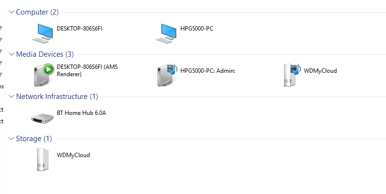

    Essentially, the WD MyCloud sometimes appears as a computer on Windows Explorer > Network but most of the time does not. Sometimes it will appear as a computer on Windows Explorer > Network but when you click on it, the device will fail to make a connection with the WD My Cloud. On the occasion it does make a connection you will not be able to swap from one user share to another which I imagine is an issue with Windows Credential Manager but even when you clear all associated log ins to the MyCloud on Windows Credential Manager and restart the system it still refuses to connect to a different user share.
    I understand there has been a running sequence of incompatibilies with Windows 10 from browsing this forum and others but to this date I have not found any consistent set of solutions. Are Western Digital developing an updated firmware with successful compatibility with Windows 10?
    I have performed a quick self diagnostics test and no issues were found.
    Screenshot below from a laptop running Windows 10 Home 64 Bit Version 1803 OS Build 17134.407. I have performed a network reset on this laptop and the WD MyCloud shows as a storage and media device but still it does not show as a computer so I cannot attempt to access the files through windows explorer. SMB 1.0/CIFS/Automatic Removal/ Client/ Server are all ticked.

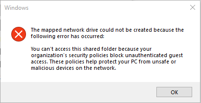

    Update: I tried mapping a network share which used to work and is how I used to access all drive shares quickly for ease of use. On our worst performing laptop running Windows 10 Home 64 bit (Toshiba Satelite T130-11H running an Intel Pentium U2700, 4GB RAM and a clapped out 5400rpm hard drive) there is still one saved mapped network connection that connects successfully but of course the laptop struggles to browse NEF files in Windows Explorer due to the awful HDD but mainly its weak CPU. I tried mapping the same network share on a more capable desktop PC running Windows 10 Education but I get a different error.
    WD MyCloud - Very intermittent connection and inability to switch user shares on Windows 10 72394913-7c53-462c-ab49-f7c879b5bf35?upload=true.png
    I then tried this again on another laptop running Windows 10 Home 64 Bit which never detects the WD MyCloud as a Computer in Network and it successfully mapped the drive. Still not sure why that won't work on Windows 10 Education or why the drive won't display as a Computer on Network on any device running Windows 10.
