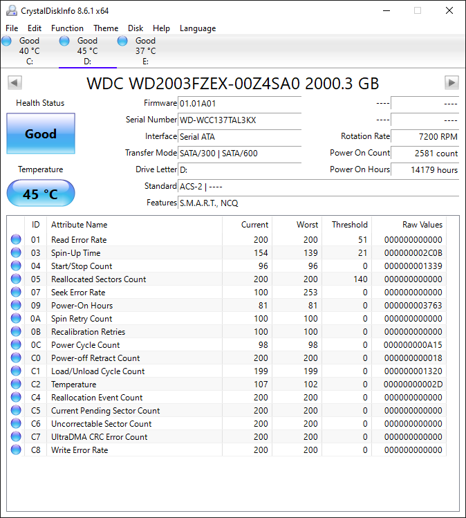

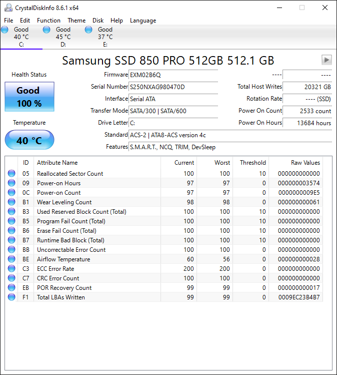

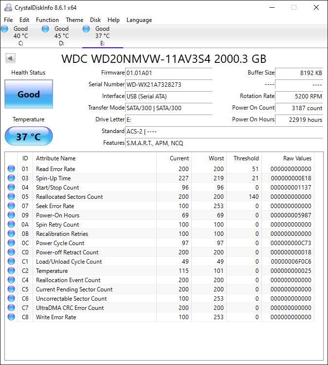

    Running Crystal Disk Info appears to be all ok
    Webcam causes my PC to occasionally freeze and lag even when It's off 284481d1592758349t-occasional-pc-freeze-crystaldiskinfo_20200621142927.png
    Webcam causes my PC to occasionally freeze and lag even when It's off 284482d1592758349t-occasional-pc-freeze-crystaldiskinfo_20200621142942.png
    Webcam causes my PC to occasionally freeze and lag even when It's off 284483d1592758349t-occasional-pc-freeze-crystaldiskinfo_20200621142951.png
    Crystal Disk Mark also show no problems for the D: drive

    Nothing showing in the Event Log apart from during restart a message that the system had closed down unexpectedly, no other information.
    One other thing I noticed when digging around I ran msinfo32. It showedInstalled Physical Memory (RAM) 8.00 GBTotal Physical Memory 3.99 GB
    Wondering if this suggested a RAM issue I rebooted into BIOS setup to see if there was anything odd. All looked ok so exited without saving any inadvertent changes. On restarting the Total Physical Memory is showing 7.99GB. While the Available Physical Memory will fluctuate depending on system activity, I wouldn't have expected the Total Physical Memory to be anything other than 8GB (near enough).
    It occurs to me that seeing that on both days the freezes occurred soon after the morning boot whether there's some system activity that is causing the problem.
    I'm not sure where to look further. Any ideas?
