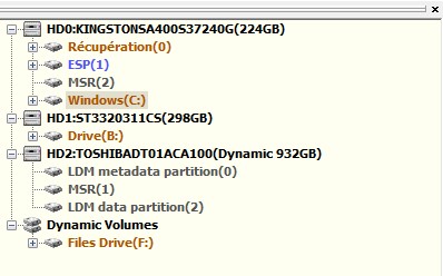

    My partition table seems a bit over the place ;can some one please tell me if that's a normal one ,i mean what are the ESP ,MSR ,and LDM partitions for ? and should they be normally present ?
    Weird Partition Table ,and second OS wont be deleted from UEFI boot entries 9f1dd5ed-7391-4af8-bef7-916dd7238c9d?upload=true.jpg
    Also i installed an Android x86 fork like 3 years ago ,i followed every possible step to delete it ,everything was deleted succesfully ,but it still persists in the Boot entries list ;no matter which app i tried ,it wouldn't get deleted ,also ,
