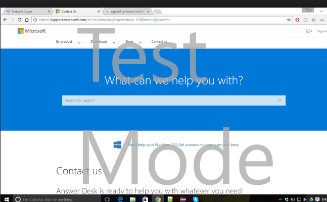

    I am having the Test Mode watermark text appearing on my screen. I have followed three set of instructions:
    1. Type 'bcdedit -set TESTSIGNING off' in cmd as admin
    2. Disable driver signature enforcement in UEFI/BIOS initialization
    3. Disable driver signature enforcement via the Troubleshoot ->Advanced setup -> Startup Settings and press Restart, and then press 7
    The problem is after rebooting the watermark disappears for a short while and then reappears. Btw its not the one in the bottom corner on the homescreen but the large writing at the centre of the screen. It appears over every window. Very Annoying. Is there
    a permanent solution? Please see attached image
    What I did to fix Test Mode watermark 266f6b3f-ade5-4012-bda2-881faf82d867?upload=true.png
    SufyanX, Jan 24, 2024
