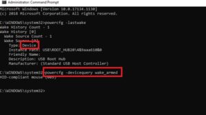

    I've also battled with sleep/wake issues over the years, and from experience have learned that trying to find, or rationalise, the root cause is a waste of time. All you need is `powercfg`.
    `powercfg -devicequery wake_armed` from an Administrator PowerShell window/Command Prompt will give you a list of all devices that can possibly wake the PC. This command is interesting because very often, it will show devices that you'd never expect being able to wake your computer. I think in one instance I had the chipset device listed!
    `powercfg -devicedisablewake "device_name_from_device_query"`will prevent said device from ever waking the computer. This command is 100% the only thing I have found that will resolve sleep/wake problems. Updating drivers, unplugging peripherals, switching to a cleaner power supply (UPS), changing ethernet cables... none of those have helped, yet`powercfg -devicedisablewake` has done the trick.
    Note that occasionally, devices you have disabled wake for may start waking up the PC again - this happens if you plug a USB device into a different port, or occasionally when drivers are updated, because Windows sees it as a new device. In that case rerun `powercfg` to find and disable that device again.
