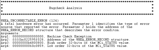

  4. WHEA Error cant find a solution Kernal 41 error 70368744177664,2
    Kernal 41 error (70368744177664),(2)
    Hello James Tawn
    I am sorry to hear that your GPU is having problems with BSOD at high loads, here are the results of the analysis of your dump file:
    As you can see from the error message in the Bugcheck Analysis, the key cause of the BSOD is WHEA_UNCORRECTABLE_ERROR (124). This is a common hardware error analysis report. As shown in the diagram:

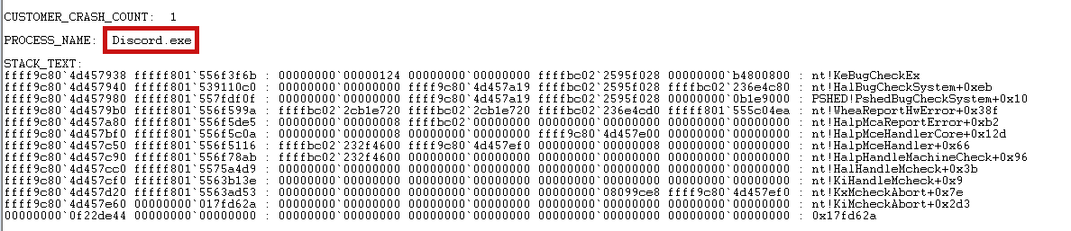

    The process that causes the blue screen error to occur during device operation is Discord.exe, a stack trace indicating that a computer check exception has occurred on the system, usually this is when the CPU detects a non-recoverable hardware error similar to the nt! error, as shown in the red box:

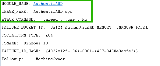

    In this case, the specific error code is 0x124, which is a common code for machine check exceptions. The module name is [AuthenticAMD], which suggests that the error may be related to the AMD processor, but the stack trace cannot log more information about the error because the system has stopped running when the BSOD appears. as shown in the green box.
