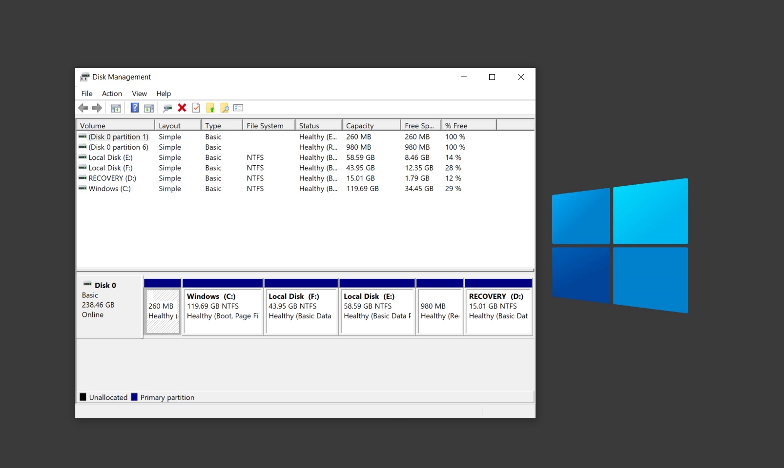

    When you don’t need to “Safely Remove” a USB drive on Windows 10 Windows-10-Disk-Management.jpg

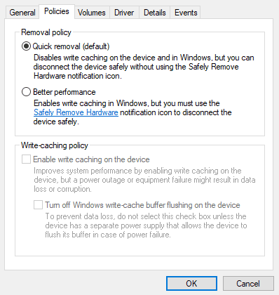

    To do this, open the Disk Management tool and right-click on your USB drive, and select “Properties,” then open the “Hardware” tab, and open “Properties” again.
    In the Properties tab, head to the “Policies” tab, and you’ll find two options — Quick removal and Better performance.
    When you don’t need to “Safely Remove” a USB drive on Windows 10 Drive-removal-policies.png
    If you see that “Quick removal” is the default, you’re good to go and you can close the window. This ensures that caching is disabled and it’s safe to remove the drive.
    But remember that this may degrade system performance. When you use the second policy, Windows can cache write operations to the external device and apps will work smoothly if they had already written the data.
    With better performance (caching) enabled, it’s very likely that that data will be tied up with some background process on your PC. On that note, Microsoft recommends you to use the safely remove hardware option.
