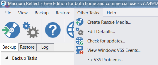

    Hi, two repair utilities come to mind:
    a. Tweaking.com's free cautious repair tool offers a number of repairs. One of them is VSS.
    Just search for it: select only the repair you need, and follow the preparatory steps.
    b. Macrium Reflect offers a feature to fix VSS issues:
    Which VSS should be disabled or enabled? 279969d1590267183t-vss-corrupt-need-enable-create-backup-untitled.png
    Troubleshooting Microsoft VSS errors - KnowledgeBase v7.2 - Macrium Reflect Knowledgebase - KnowledgeBase v7.2 - Macrium Reflect Knowledgebase
