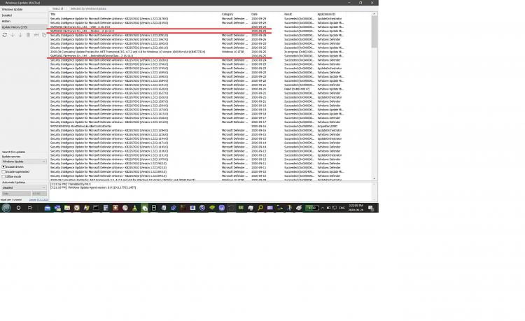

    This may be coincidental or maybe not. I have Windows Update disabled and use a third-party app to download updates and/or driver files of my choosing.
    Recently, I've been offered and installed 3 Samsung related drivers. I have used Samsung's SmartSwitch to backup my Samsung A8 phone for a couple of years and now suddenly the process is all messed up.
    As previously mentioned, you might want to look in your Windows Update History and see if you have the following 3 Samsung driver files recently installed. Check to see if the installation dates coincide with your grief. *Smile
    While I was transferring my photos to my laptop via my phone, the upload suddenly stopped... 299573d1601408184t-suddenly-cant-upload-photos-phone-0929-samsung-driver-files.jpg

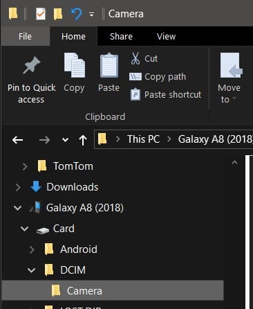

    I'm still able to access pics from my phone using Windows File Explorer. How are you attempting this Barnum?
    While I was transferring my photos to my laptop via my phone, the upload suddenly stopped... 299580d1601409047t-suddenly-cant-upload-photos-phone-0929-samsung-a8-pics.jpg
    W10 Tweaker, Mar 12, 2024

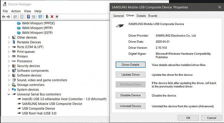

    I believe the update on the 25th was the USB driver which you will only see while your Samsung device is connected to a USB port. This is the update that Farvatten has removed. I have access with Windows Explorer, but not with SmartSwitch.
    While I was transferring my photos to my laptop via my phone, the upload suddenly stopped... 299598d1601413327t-suddenly-cant-upload-photos-phone-0929-samsung-mobile-usb.jpg

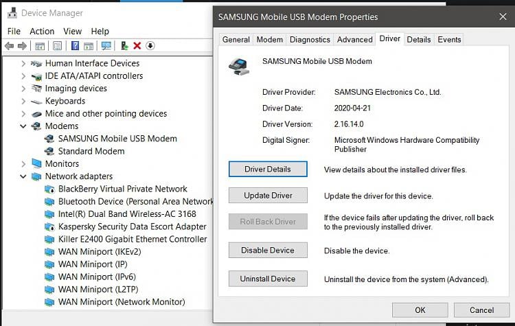

    This next driver is listed under modems but only while a Samsung device is connected.
    While I was transferring my photos to my laptop via my phone, the upload suddenly stopped... 299603d1601413459t-suddenly-cant-upload-photos-phone-0929-samsung-modem.jpg

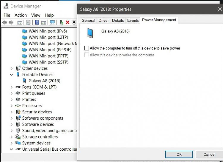

    In the Device Manager under Portable Devices/properties/power management tab, check to be certain the checkbox is empty for allow the computer to turn off this device. Again, your Samsung device must be connected to view this entry.
    While I was transferring my photos to my laptop via my phone, the upload suddenly stopped... 299604d1601413610t-suddenly-cant-upload-photos-phone-0929-portable-devices-properties.jpg
