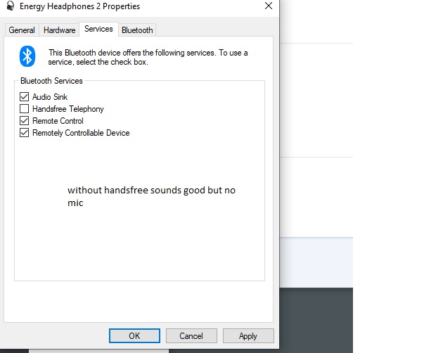

  3. cemy Win User
    BT headphone no mic on win10pro
    hello, I've tried to use BT headphone on windows10. But when speaker works mic stops. when mic works speaker stops.
    There is two options in my sounds settings stereo and handsfree. Stereo has no mic option. Handsfree has but bad sounds quality on speaker. I want to use mic with good speaker.
    What did I tried to solve
    1- Reset all BT services
    2- uncheck Handsfree on headphones preficens
    3- Set manually speaker and microphone devices
    none of it works..
    Any thoughts?
    Why cant i set headphone to headphone with mic? 275187d1587225793t-bt-headphone-no-mic-win10pro-e.png
    Why cant i set headphone to headphone with mic? 275188d1587225793t-bt-headphone-no-mic-win10pro-d.png
    Why cant i set headphone to headphone with mic? 275189d1587225793t-bt-headphone-no-mic-win10pro-c.png
    Why cant i set headphone to headphone with mic? 275190d1587225793t-bt-headphone-no-mic-win10pro-b.png
    Why cant i set headphone to headphone with mic? 275191d1587225793t-bt-headphone-no-mic-win10pro-.png
